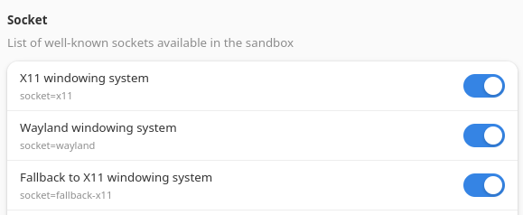

it seems you got it from Flathub and recently updated, it may be missing permissions to access either X11 or Wayland sockets so that it can actually show a window.
You can edit app permissions with Flatseal and double-check it has access
For reference, this is what it should look like:

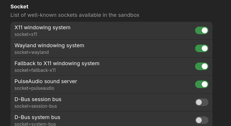

Flatseal:
