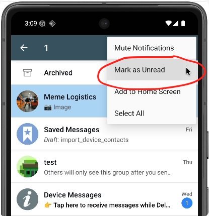

there is some progress on this feature, we did a core implementation already, it will land in one of the next releases, sooner or later :slight_smile:
yeah! meanwhile, the feature is rolled out.
it is available at places you would expect it to be:
