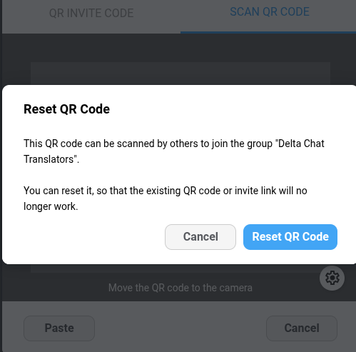

this is also possible in desktop, I just realize there is no explicit “reset” option in desktop which is a bug/forgotten feature, but you can still revoke it by clicking the invite link you want to revoke
right-clicking the QR code offers “Reset QR Code” also on desktop.
